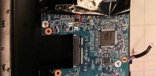

Lenovo Thinkpad X1 Carbon 3rd Gen hang at bios lock screen. Original Bin attached
  • Thinkpad X1 Carbon 3rd Gen.Bin
short sda scl when thinkpad logo appear and press f10
and disable admin security
