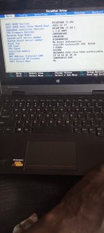

turn on the laptop. when display came immediately short 200&202 pin of ram .laptop run into setup directly or pressing f1. when setup open then release pins.go to security press anter 3time in administrator password. save and exit your password is broken.Please help me remove lenovo yoga 11e bios password.
Does programming bios remove passwordturn on the laptop. when display came immediately short 200&202 pin of ram .laptop run into setup directly or pressing f1. when setup open then release pins.go to security press anter 3time in administrator password. save and exit your password is broken.![]()
noDoes programming bios remove password

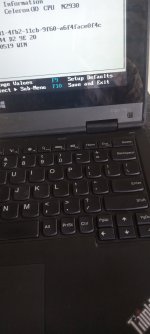

This is the laptop
yes try the mathodeThis is the laptop
Not workingyes try the mathode

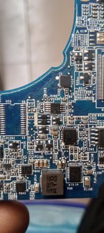

This is the motherboard. How do I go about itNot working

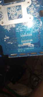

send me picture of ic no 30 or 30-1This is the motherboard. How do I go about it
This is itsend me picture of ic no 30 or 30-1
This is it
ok just replace the ic no 30 with any ic take from other lenovo board like t420\520\430\530 etc all these model have same ic inshaALLAH password will breakThis is it
You are on point.. I do remove the ic on some Lenovo laptops it will remove password.ok just replace the ic no 30 with any ic take from other lenovo board like t420\520\430\530 etc all these model have same ic inshaALLAH password will break

The main and ec?Send bios backup
The main and e
bothThe main and ec?
Thank you very much..I removed the ic, password removed. Thank you everyoneallhamdulillah we break around 1000 pieces password with this mathod
