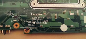

Hello,
I have a question. I currently have a T480S, and I extracted the original BIOS. Then, I tried to use a T480S BIOS I found on the forum. I turned on my computer, and initially, the power LED blinked 3 times, then nothing. So, I tried to restore the original BIOS. When I connect the power cable, the charging LED lights up red and then goes off, and the power LED lights up white and then goes out. In the end, the computer doesn't turn on anymore.
Do you have any idea how to get it to turn on?

Could you please send the motherboard model and the Bios file which has password?
jayson1985
Thank you for your response. I hope the original BIOS is not corrupted.
Thank you for your prompt response. I've injected the new "UNLOCKED" BIOS. Then I powered on the motherboard, but nothing happens. (see the video) Before performing the BIOS manipulations, the motherboard powered up correctly. I was able to set a BIOS password to conduct my tests. Since I ran my tests with other BIOS versions, the motherboard no longer responds.
Based on your experience and that of your colleagues, have you ever encountered this type of issue? Thank you for your help =)

As you can see in the video, I don't have a white indicator light when I press the power button. It's as if an instruction was given to the motherboard not to start. I'm thinking about the super SIO for example.
